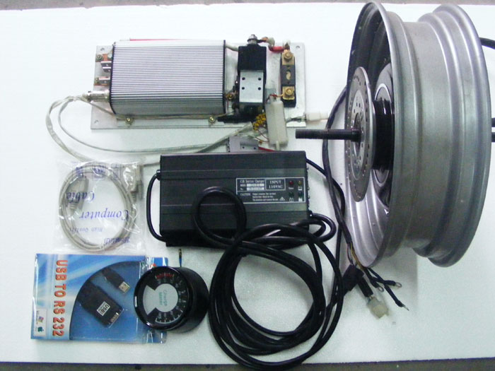

sera que um motociclo hibrido era melhor do que comprar um ve?
aqui esta ou kit da kelly motors com 1400$
keb72801 kit
weight: 62 lbs.
stock: 50
the kit can be trimmed to meet your needs.
the top speed can arrive at 130 km/hr.
keb 72801(72v 8kw regen)*1
72v 6kw brushless hub motor(13-inch,1000lb to 80mph
)*1
compact assembly*1
hwc 1b series 72v 8a charger*1
meter led 72volt state of charge*1
pc rs232 cable*1
usb to rs232 converter*1
can do regenerative braking.
best for high performance ebike/scooter.
can upgrade to hwc4b 72v 15a smart charger with $199.
1400$ kit para hibrido

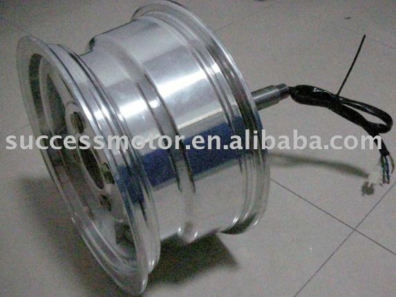

um hub motor para as jantes:
mais um testemunho:
