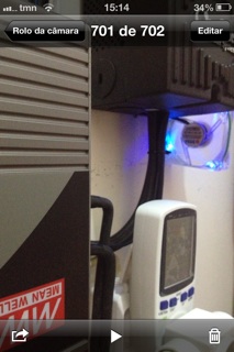

Quando nao apetece fazer-se outras coisas inventa-se....
Tinha um cooler ali numa caixa, resolvi colocá-lo ali
Aquilo consome pouquinho e uso a saída do outback para control

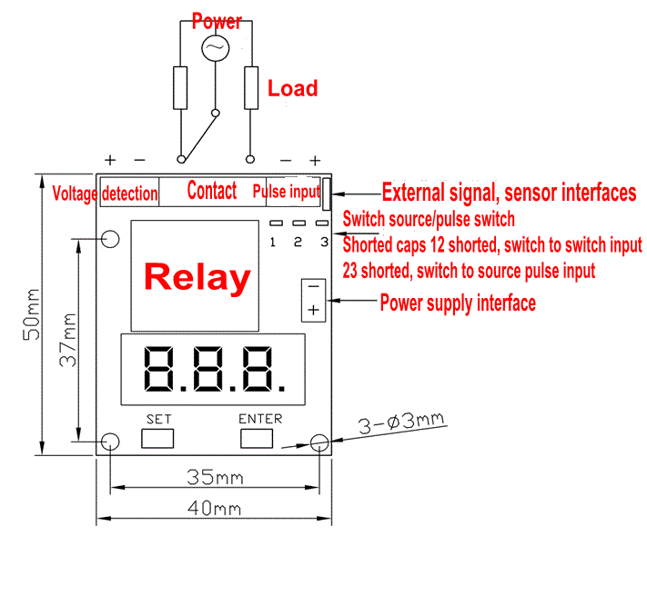

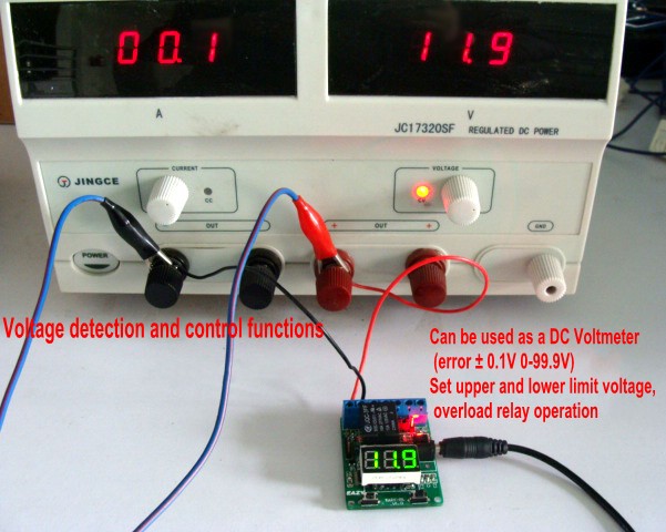

mais uma chinoquice que adquiri e acho que vai dar muito geito ainda nao sei em quê, mas irá ter alguma funçao.
esta plaquinha chinoca tem um monte de aplicaçoes possiveis, desde temporizador, a sensor de voltagem....
pode ser bastante util nas bricolages electricas.
deixo uma imagem e a designaçao dela no ebay para facil pesquisa:
Voltage control relay/timer/delay switch overvoltage/under voltage protection

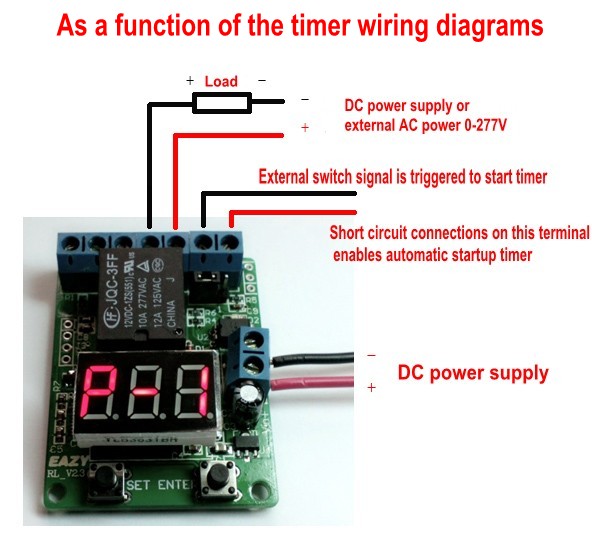

olha so a potencialidade desta placa chinocavisitante2 Escreveu:Parece ser porreira.
Qual a faixa de deteção de voltagem ?
http://www.ebay.com/itm/Voltage-control ... 5d3e166fb6
By setting P-1 in timed mode, delay model and P-4, P-5 model P-2 combination program enables a variety of applications:
1. The required test voltage across the 14.5V connected load for 5 minutes and then disconnect, load disconnect when the voltage is less than 11.5V.
Setting method: first to a P-1 mode, set T1 to time 5 minutes, T2 is 0, then out of P-1 into P-4, and set the voltage up to 14.5V, voltage lower limit is 11.5V, load relay normally open.
If you would like a voltage higher than the 14.5V disconnect the load, less than 11.5V load 5 minutes to connect and then disconnect, press SET key for 3 seconds to inversion of relay logic.
2. Test voltage exceeds 14.5V delay 5 minutes and then connected to a load, load disconnect when the voltage is less than 11.5V.
Setting method: first to a P-2 mode, set T1 to time 5 minutes, T2 is 0, then out of P-2 into P-4, and set the voltage up to 14.5V, voltage lower limit is 11.5V, load relay normally open.
3. The requested test voltage is lower than the 14.5V delay 5 minutes and then connected to a load, load disconnect when the voltage is less than 11.5V.
Setting method: first to a P-1 mode, set T1 to time 5 minutes, T2 is 0, then out of P-1 into P-5, and set the voltage up to 14.5V, voltage lower limit is 11.5V, load relay normally open. Long press SET key for 3 seconds to start the timer when the voltage is lower than the lower limit, in this case, when voltage is lower than the lower limit, you are starting a scheduled 5 minutes closed directly above the upper limit of voltage.
4. A battery 11.5V you want to switch to the charging circuit and then charged for 10 minutes, than the 12V switched to load circuits.

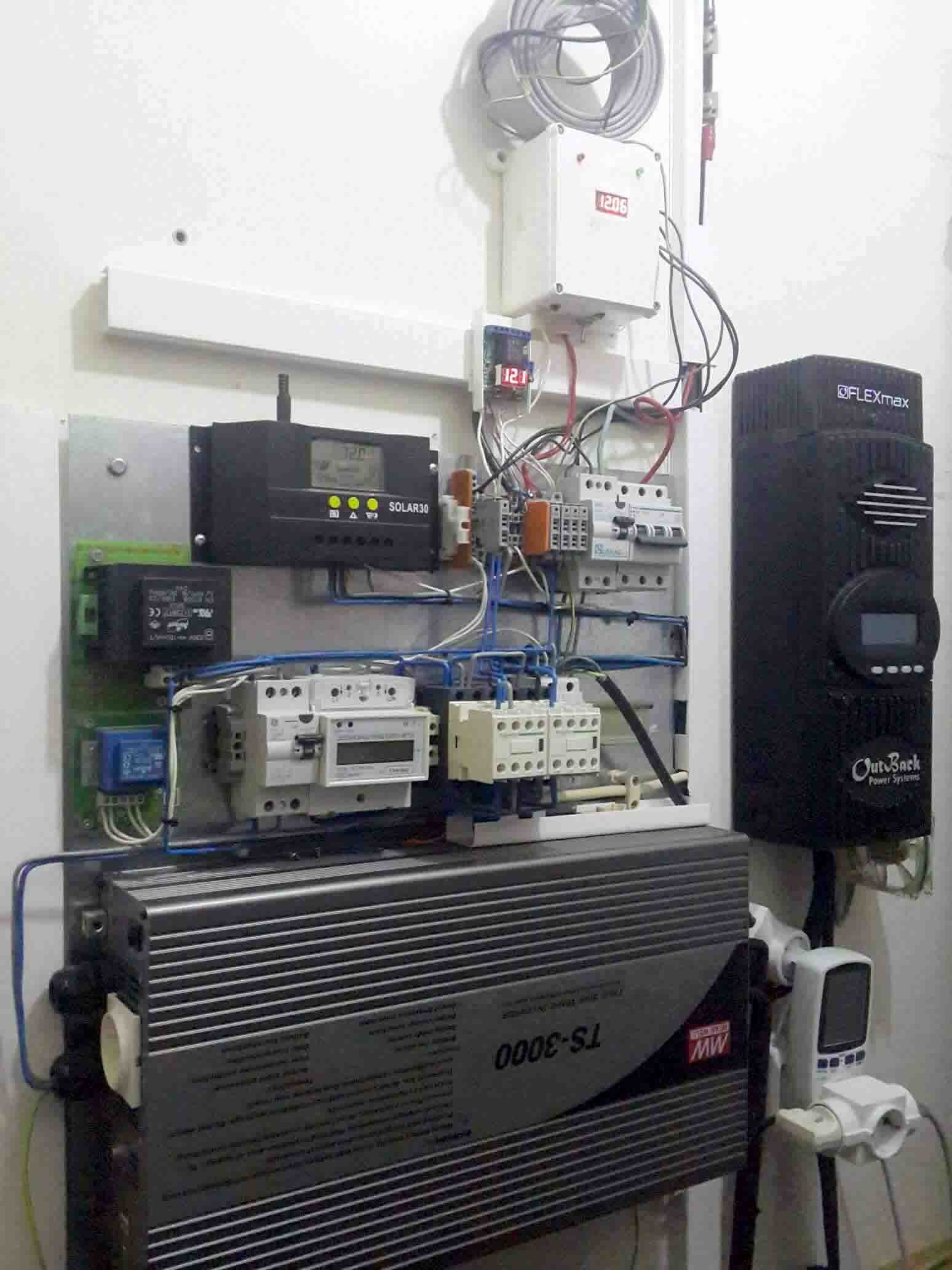

ja algum tempo nao passava por cá,
o calor chegou e hoje acrescentei uma funçao no meu micro sistema que tem funcionado sem problemas até agora
aqui fica uma imagem
- 20140317_230952 cópia.jpg (104.86 KiB) Visto 4492 vezes

Re: Quadro elétrico em construção. quase terminado!
Será o contador de energia?
- Mensagens: 4093
Se foi tenho um exactamente igual a esse
