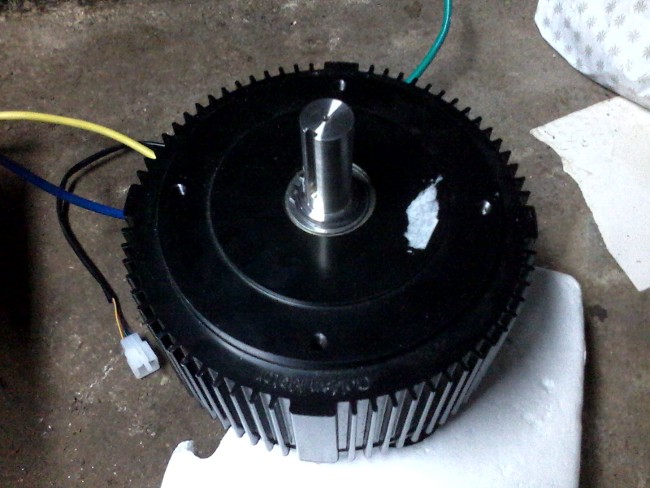

Quais são as especificações desse motor?
Re: 1994 Suzuki GSXR-EE
Enviado: sábado jul 07, 2012 7:34 pm
por Barrocas
As especificações listadas no website do fabricante, Golden Motor:
Model: HPM5000B -- High Power BLDC Motor
Voltage:24V/36V/48V/72V
Rated Power:3KW-7.5KW
Efficiency: 91%
Speed: 2000-6000rpm (customizable)
Weight:11Kgs
Casing: Aluminium
Length (height): 126mm
Diameter: 206mm
Shaft: customizable
Features: Compact design,Water resistent, Stainless Steel Shaft, Self Cooling Fan
Applications: Electric car, electric motorcycle, electric tricycle, electric golf carts, fork lift, electric boat, etc.
2011-09-08 Golden Motors HPM5000B_3_650px.jpg (82.58 KiB) Visto 19682 vezes
