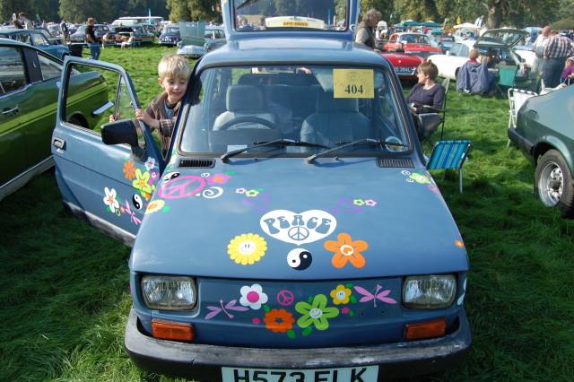

mais um mas este já concluido!1992 fiat 126 bis
very small car, chosen for its size. it was the smallest i could find with 4 seats. also considered aixam and microcar but i felt they were too expensive, the 126 is becoming a classic and spare parts are easy to find and cheap. the new tata nano is interesting though, will keep an i on that one.
motor agni 95 turn reinforced permanent magnet dc
a pancake motor designed by cedric lynch. motor is on order, hope to have it this month (feb 08).
motor is rated at 200 amps continuous and 400 amps for 30 seconds.
controller kelly 72401; 400 amp pm with regen.
kelly is a newcomer to the ev market. it was the only one i found that could operated at 72 volts and give me regenerative braking. this is important as the car only has drum brakes and at 28 kw peak power is higher than the original engine was rated at. kelly use 24 volts for the control circuitry so i have ordered a 24v dc/dc converter. i did consider tapping the traction pack at 24 volts.
dc/dc converter kelly controllers 12 volt 35 amp and 24 volt
kelly also offer other components as well as controllers, so i have ordered 2 dc/dc converters, 12v for the lights, etc and the 24 volt for the controller, contactor, etc.
